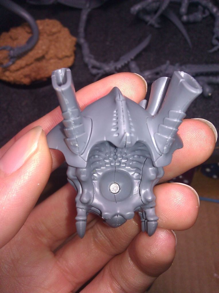

Step 1

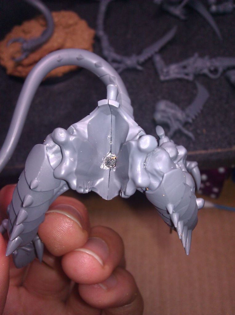

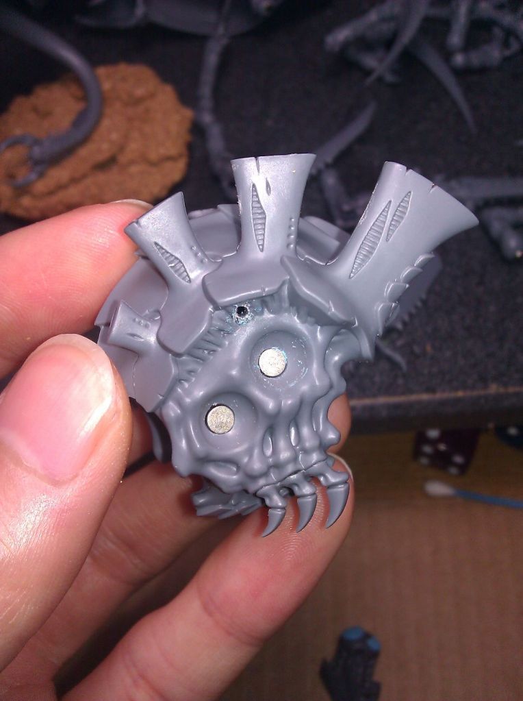

I started out simple and magnetized all the joints that we will need for the weapons, shoulders, torso, and abdomen attachments.
An Image
shoulder sockets
(I'll explain why there's a small hole there a little later)

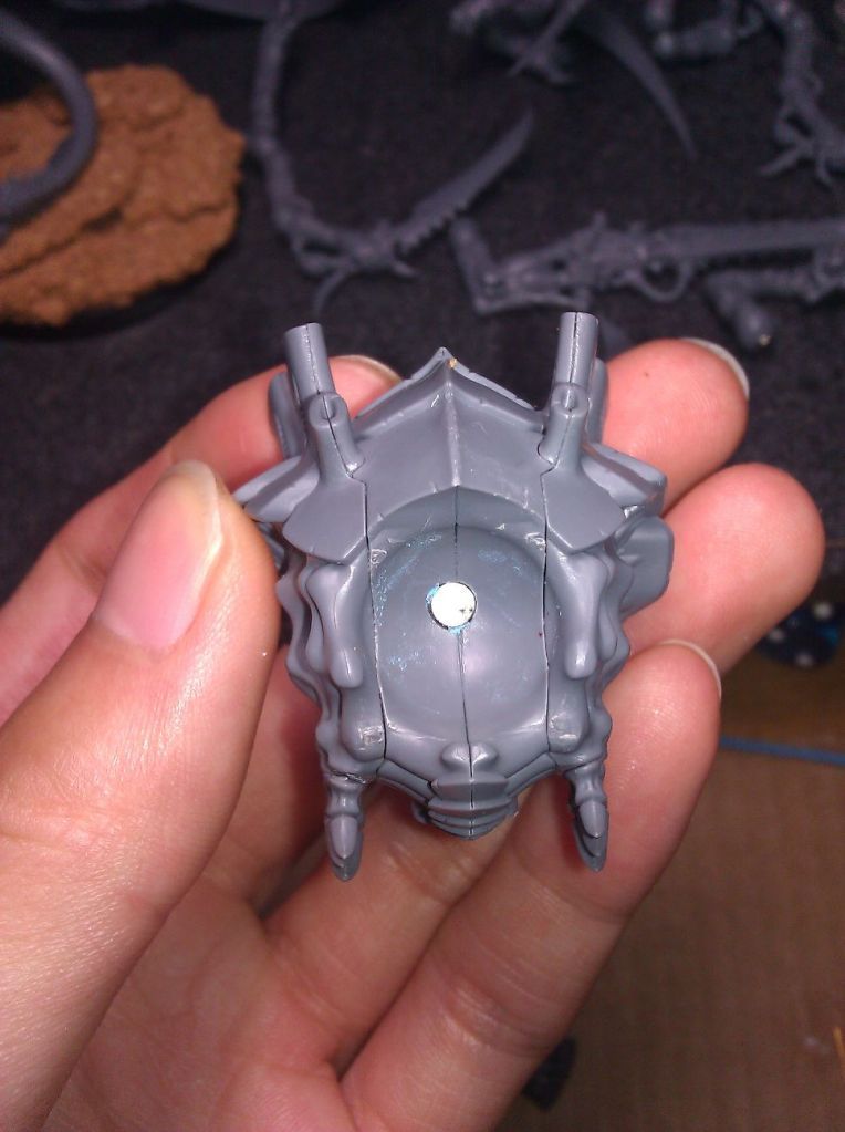

An Image
bottom of torso

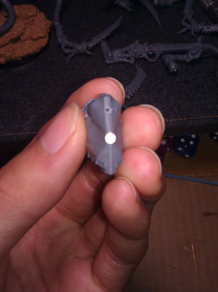

An Image
this is the ball-abdomen joint; i magnetizing the top and the bottom of the piece

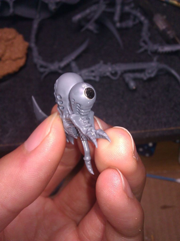

An Image
head

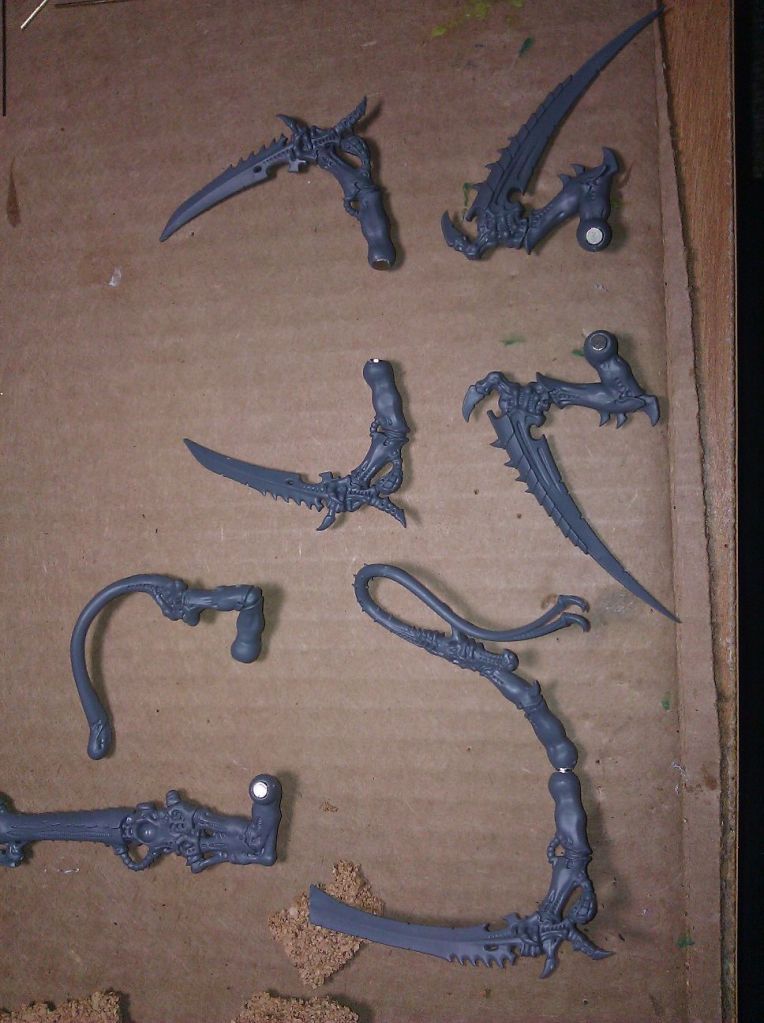

An Image
the various weapons
