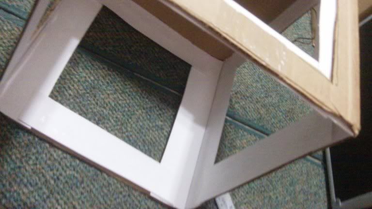

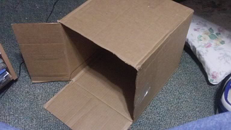

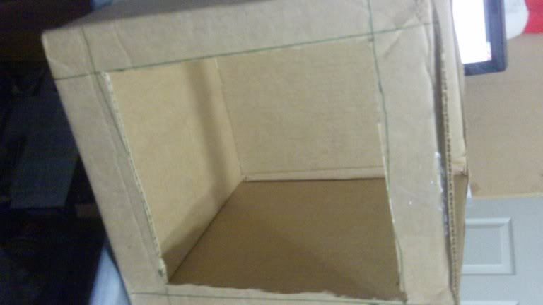

The first thing you wanna do is cut off the top flaps of the box. Make sure the bottom is secure by either taping or gluing the bottom.

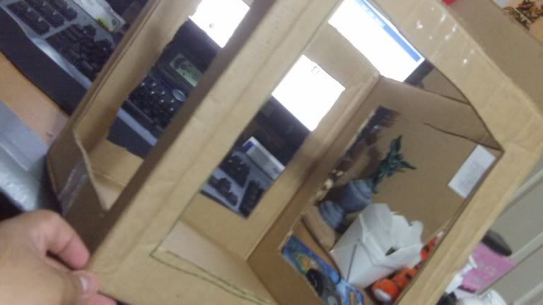

Next you want to cut 2" away from edges to form a frame. This pic is a good example

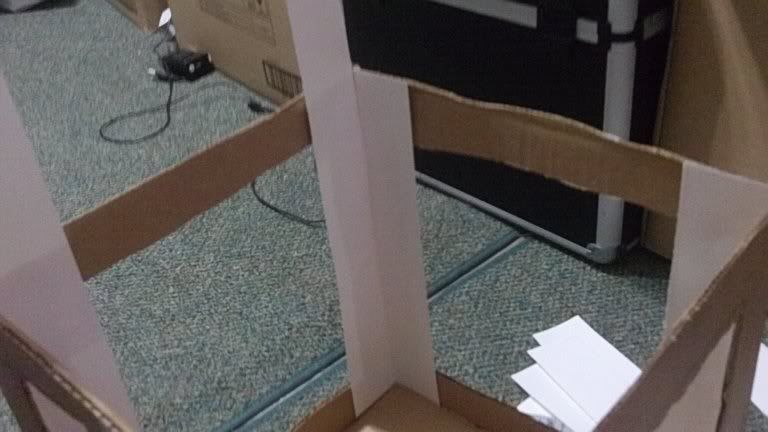

Basically you want to to this to all of the sides EXCEPT the bottom. The end result should look like this.

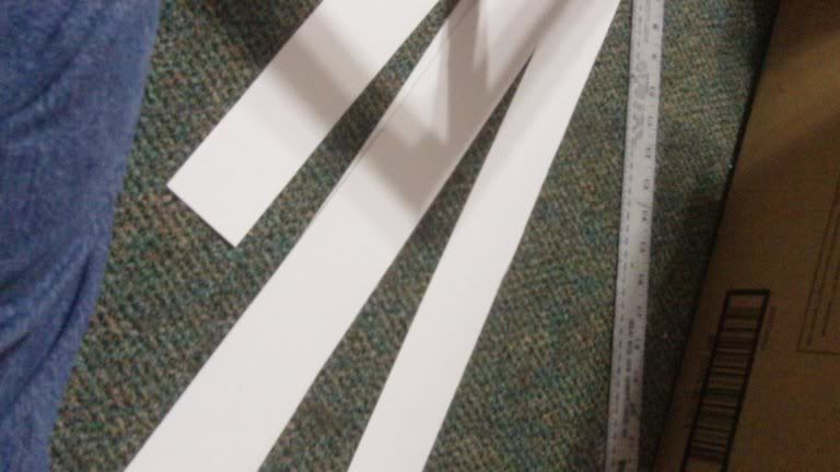

Once this is done you can begin to cut 2" strips of yer whiteboard/bristol/posterboard.

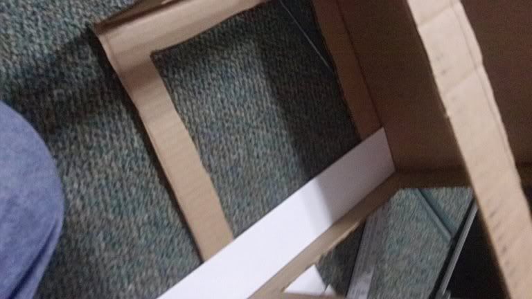

Once the strips are cut you can use glue or a glue stick to past them to the inside. This is a tedious process but is necessary.
You can either cut these to the exact size or if you are lazy just apply them and trim off the excess.
The end result should look something similar to this.

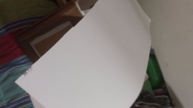

Then you can take a strip roughly the width of the interior of the box and place it inside. You want it to be longer than the box's diagonal diameter. So that it curves a bit.
I forgot to take a pic of it here, but you can get an idea of how to do it if you look at the lighted post.

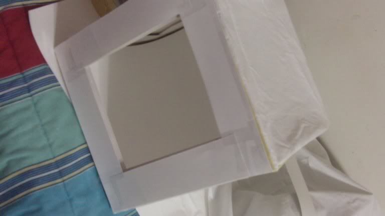

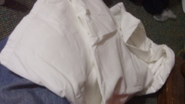

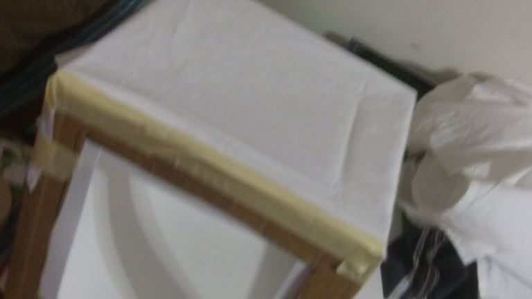

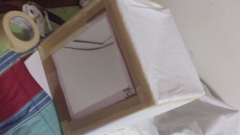

Here is where the white fabric comes inplay. I actually used an old white bedsheet that I have been using as a back drop for some other things.
What you want to do is cut peices that are bigger than each of the sides. Begin by applying the peice to the top. This is the side that you cu the flaps off of, or what was originally the top of the box. Secure it using masking tape, feel free to be generous
Repeat the process on the remaining sides, which is really only going to be the left and right. Secure it the same way, try not to get tape over the main parts as this will cause unwanted shadowing.
To be honest once this is done you are pretty much done. I used the left over bits of strip to clean up the front facia. Then i took a peice and reinforced the back. Ive no pics of the back but this is the finished product.

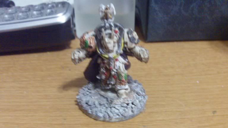

The fabric will be the most expensive part of this project. It will bring up the total build from about 4 bucks to maybe 7. But if you have some lying around it makes it easy. The box is great to help cameras focus and pic out details. Basically you can take something like this...
And by placing it in the box.. allow cameras to really utilize their focus on the macro mode, and really pull out details and give you a completely white background... or this...
