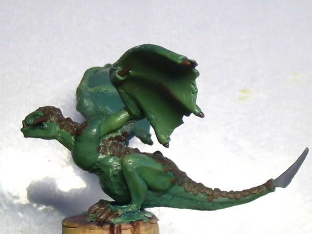

I did not have too much of a plan to begin with really. I used a paperclip frame held together with wads of greenstuff in a rough lizardy shape. Might have actually been trying to construct a squig, I forge exactly. But in the end, it screamed wyvern to me, so I let my heart do what it wanted.
Basic Body.

I replaced the tail barb with a better looking piece of carved scrap sprue.
An Image
I redid the chest muscles. I did not like how I had them before so I attempted to make it look a but more heavier and powerful.

Scales going up the back neck and over the wing shoulders.
An Image
Back view

added details of wing bones on the underside of wing, did a fair amount of scraping to smooth greenstuff around the hand of the wing.
An Image
Claw tips added to wing finger tips.
An Image
Sculpted base using greenstuff and the billy mays putty. Likely even some of my hallways floor tiles. They were busy disintegrating while the building management didn't do anything about it. So I use the bits in my models.

Nope no step by step. I have a thing for purple. The blue needs work. I've yet to decide how to fix the blue scales, but for the most part, not too bad.
An Image
Finished Baby Wyvern
An Image
Baby Wyvern and Snotling friends.
It took me about a week or two to complete the model. I hopefully will get around to explaining my various tools and sundry,
